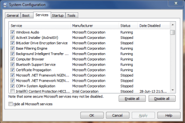

This is the path to the bluetooth service - but that may not help you either. Looks like some .dll.
C:\Windows\system32\svchost.exe -k bthsvcs
Click on "Hide all Microsoft services" and see what it looks like.
Do you use (need) a Bluetooth device?
If you don't, you can uncheck the MS Bluetooth Support Service, reboot, and see what happens.
If you find you do need that service, you can re-enable it.
If you are using a Bluetooth Mouse/Keyboard, don't disable the service - you do need it.

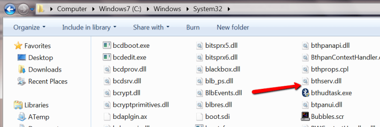

Hey guys,
Turns out that this service is not what I see in my tray, nor is it the initiator of some sort of 'tray.exe' program, as even with the service disabled, the bluetooth-tray-icon appears. Still no idea what it is, where it is located and how it startsup automatically. Neither MsConfig, nor Autoruns, nor Process Explorer shows anything else seemingly related to Bluetooth...
Vista and Seven
Seems like that might have something to do with it...
