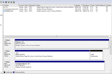

I've got three HD's: c: is windows, g: is a storage drive, and e: is an external storage drive.
In the last month or so at startup, windows has tried to run a checkdisk on G: but it fails every time. I'm trying to figure out how to format G: because its giving me endless trouble.
I backed it up, went to computer management, and was given the "Windows cannot format the system partition on this disk" error.
How do I move the system partition to c: so I can format g:?
I've read some threads that seem similar where people suggest using BCDEDIT--is that what I should be doing?
thanks for the help!
joe
EDIT: Also, I'm no expert, so I have no idea how in the hell system files got onto my storage drive in the first place...
Welcome to Windows Seven Forums.
You have two partitions (C and G) marked as active when only your Windows drive C should be active as it is the boot partition.
You need to deactivate the G drive: How to deactivate an active partition?
Once you've done that you should be able to format your G drive.

Ooops never mind, that didn't solve it at all. It did make it so that I could format, but I decided to reboot first just in case, and now it won't boot at all.... is there a way to undo what I just did?

This is why Win7 HD should always be plugged into DISK0. The installer looks for the first Active partition to place the boot files, in this case a data HD.
Boot your Win7 DVD Repair console or REpair CD, accept any offered Repair. If Win7 doesn't start, boot back in to run Startup Repair repeatedly to start Win7 if it remains marked Active. If not, check it is still active using free Partition Wizard bootable CD, or Diskpart from the DVD/Repair CD Command Prompt. Partition - Mark as Active

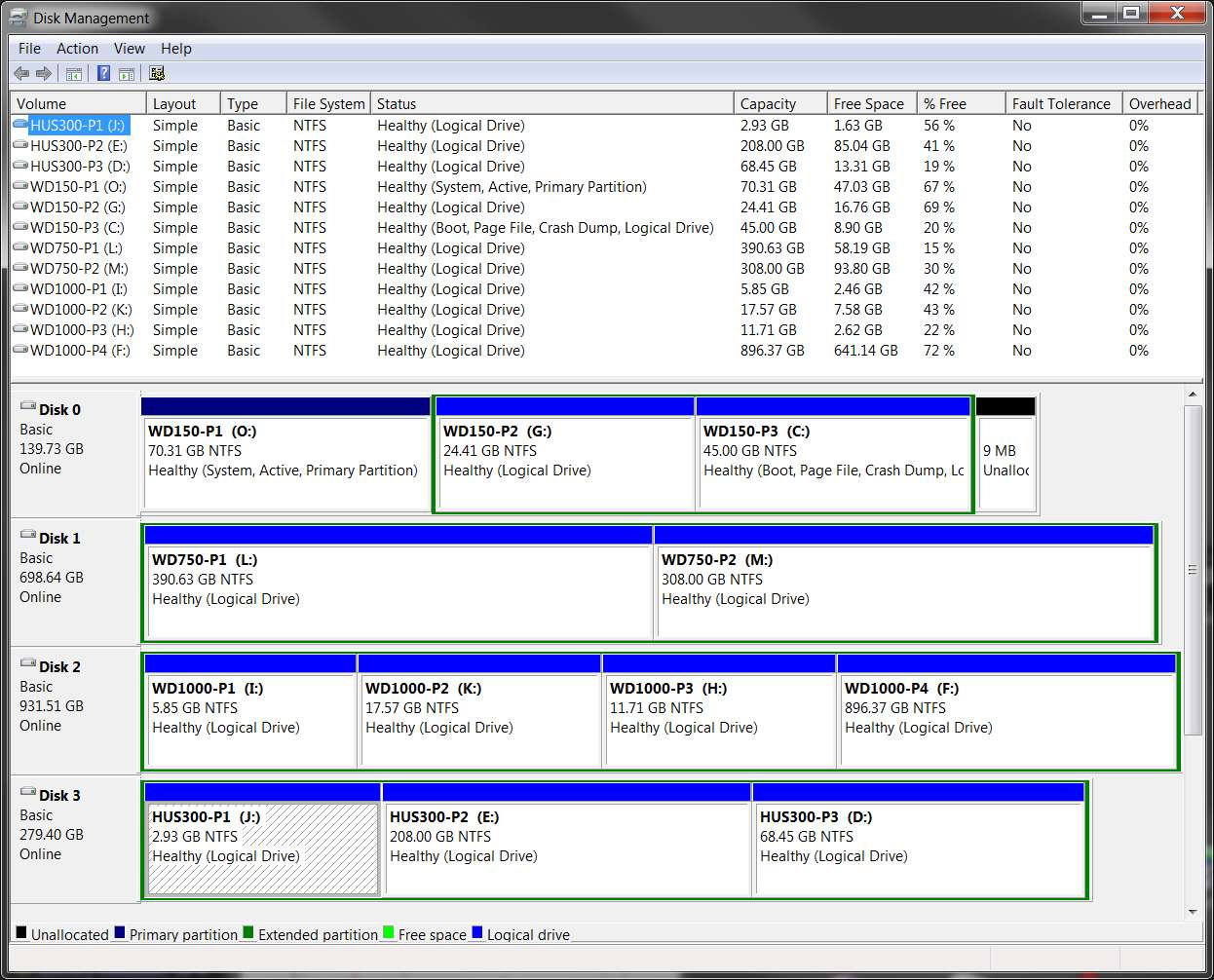

For example, here's my machine setup (from the perspective of Win7). Note that there is only one "primary" partition, which is "active" and also "hard disk #1" for the BIOS (and shows as Disk 0 and drive letter "O" to DISKMGMT and Win7). That is actually my WinXP partition, where the Win7 boot manager files live (actually, I've replaced them with the EasyBCD boot manager files), which then boots to Win7 which is on the "logical" partition C (partition P3 on the same physical drive).
==>> you can use Disk Management to do most basic partition work and reconfiguring. But for absolute maximum flexibility, reliability, and capability, you should absolutely use Partition Wizard.
