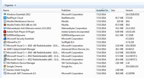

While you wait for SuperAntiSpyware (SaS) to finish, it might be a good idea to prune your installed programs.
Open Control Panel > Programs & Features
Stretch the window tall and wide enough to show the name and date installed
Post as many screen shots as it takes to show the list
When fighting malware, it's a best practice to uninstall all unnecessary applications that can easily be reinstalled (free stuff). Taskbars, search engines, 3rd party utilities are prime examples of unnecessary applications. When you've completed the malware exercise, you can install them again if you wish.
Go through what you can, starting with the free software, hold off on any purchased software for now.
If you purchased software, you need the license key to re-install those. Do NOT uninstall any purchased software unless you have the key.
I'll look though your installed programs list and make further recommendations. You have the final say on what I suggest, it's your machine.

I haven't installed much of anything. It didn't seem smart if I may have to do a clean install again.
Firefox is installed too although it's not showing up in programs and features for some reason.

Right! I forgot you reinstalled and I'm glad there's not much software to sort through.
Ok, it was a good idea to scan the ext drive - I jst wanted to let you know that scans will take a longer.
FF is there, it's Mozilla FF (4th from the top)
The only question is: Gamers Unite Snag Bar. Can you do without that for a while until all scans are done?
Did you install it?
See Google Search results
I don't know if it is a very safe thing to have on your machine. It could be the open door that lets viruses in - not sure though. Better to remove it for a short term.
Ok, next do post# 35 OldTimer (short) and then post# 37 ESET (long)
