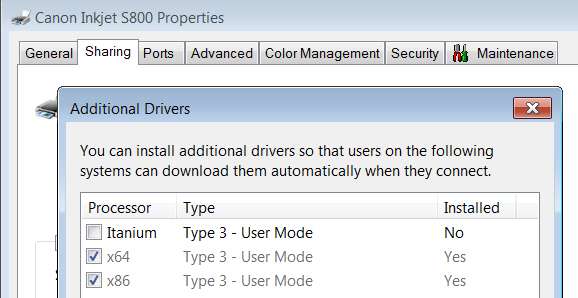

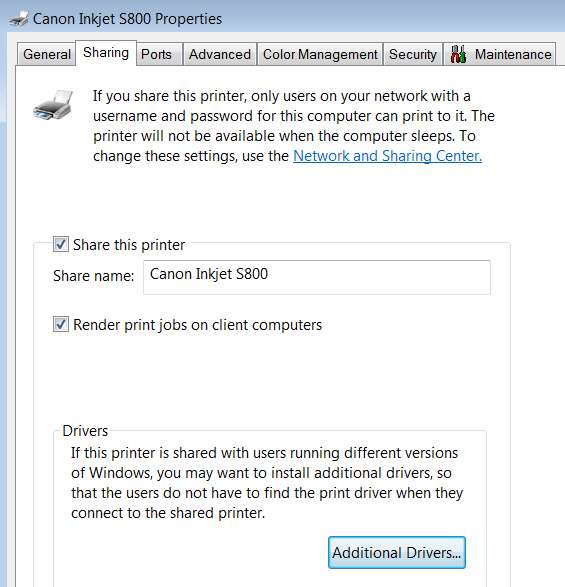

(5) Next, I wanted to "share" the two printers which were locally connected to the Win7 x64 machine, and make them accessible to the WinXP x86 machine for printing.
This is standard procedure, by using the "Additional Drivers" button on Printer Properties -> Sharing tab. You simply have to check the x86 radio button, push the OK button, and then navigate to where the INF file is located for the x86 driver. Win7 theoretically finds it there, installs it as a second driver for the printer, and now shows both x64 and x86 drivers as installed -> "YES".
Then, when the network view of the Win7 machine from the WinXP machine is opened, and the shared printer(s) selected and right-clicked, selecting the "Connect..." item causes Win7 to ship the x86 driver over to WinXP, a connection through a virtual USB port type is established (it shows as USB001 or similar in the PORT name), and bingo... you have the printer connected to and hosted by the Win7 x64 machine now available for printing both by Win7 and also WinXP x86.
This is how it is supposed to work.

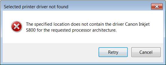

(7) Now... I wanted to repeat this exact step (6) above, but for the second printer, the S800.
Unfortunately, Canon does NOT provide a driver file for the S800 WinXP that contains the usual SETUP.EXE and INF file, which would be usable for the "Additional Drivers" install of Win7 (as I just did successfully for the MF4370 printer, because Canon DID provide a proper driver package for that printer).
Instead, Canon provides a JAVA-based installation file for the S800 on WinXP (S800_2KXP_v152.exe). If you run this file on WinXP it will absolutely run perfectly and to completion, and WILL install the S800 printer. But the S800 is presumably expected to be connected locally via USB, to the WinXP machine. And if you connect the printer locally to that WinXP machine, it DOES print perfectly.
However this is unacceptable for use in the "Additional Drivers" dialog of Win7, when trying to add that second x86 driver for the S800 that's already installed successfully in x64 mode on Win7.
In fact, if I try to go through the "Connect..." process on WinXP, having selected the visible "shared" S800 printer on the Win7 machine, the step which would normally ship the presumably installed second x86 driver over from Win7 to WinXP obviously fails, because that second x86 driver is not installed on Win7.
So... for the moment, complete failure. I could not see any way to get the S800 locally attached to the Win7 machine to be usable as a printer on the WinXP machine.

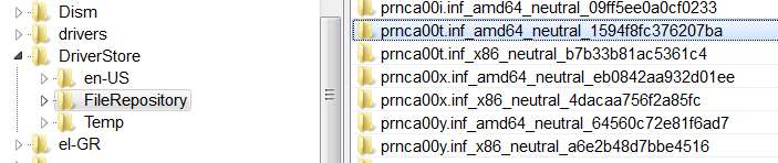

Microsoft located what they believed to be the acceptable x86 driver on their support site, based on the S800's hardware id of "CanonS8001A09" (from the printer's Properties -> Details -> Hardware ids on Win7).
This resulted in my downloading a file named:
X86-all-4455_99f589b0fa94cc06810c1edf4a11485d29d33580.cab
And when I unpacked that, sure enough it produced an INF file (PRNCA00t.inf) as well as an I386 sub-folder containing all of the relevant DLL's, GPD's, etc.
So far, this seemed promising.
(11) I then tried to use this INF file location in the "Additional Drivers" dialog for the S800 printer to add that second x86 driver. It looked like it started ok, but then stopped asking me for the location of where it could find NTPRINT.INF
Turns out this is a well known and annoying Win7 issue faced (and eventually conquered) by a number of other users. Thanks to this thread on another forum I was able to satisfy Win7's desire for NTPRINT.INF successfully. Actually, this is only a 1-time problem and once you solve it (and let Win7 install it) you will never be asked for it again for any other "Additional Drivers" dialogs you may go through for other printers.

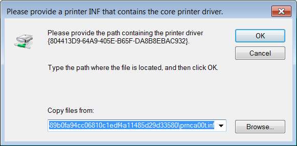

(12) Anyway, having now gotten past this first obstacle in the use of the Microsoft-provided Canon S800 INF folder that actually had appeared to get started properly before running into the NTPRINT.INF issue, I was fully expecting the "Additional Drivers" dialog to now complete successfully.
Well, no such luck.
Instead, I now got another request from Win7... asking me to point to the location where the INF file for the "core print driver" was located. And the print driver it was looking for was [804413D9-64A9-405E-B65F-DA8B8EBAC932], which is in fact the S800 driver name.

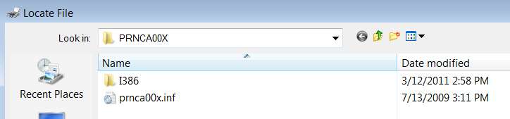

I did a Google search on that driver name value, and was able to locate another INF file (PRNCA00x.inf) which seemed to be structured a bit differently than the PRNCA00t.inf file contained in the Microsoft-provided Canon S800 folder. So I placed this second INF file in the same folder along with the Microsoft INF file, and tried again.
(13) Well... no luck. Win7 continues to ask me for that driver. No matter whether I point to PRNCA00t.inf or PRNCA00x.inf I get the same result:
So I don't know if it's really using PRNCA00t.inf or PRNCA00x.inf. But regardless, it's failing to find whatever it really wants to find.

I did a bit more investigation on the Microsoft-provided driver file I'd been pointed to, named PRNCA00t.inf.
Using a program named WinMount, I examined the 32-bit Win7 installation DVD I have, examining INSTALL.WIM.
It looks like the proper driver file for this printer was the other file I'd found through Google... PRNCA00x.inf, not PRNCA00t.inf.
I'm guessing the PRNCA00t.inf file is for this printer but for a different environment (maybe for Vista instead of Win7?). I don't know why Microsoft support latched onto that file for me with that hardware id of S8001A09 for Win7. Anyway, PRNCA00t.inf was not on my 32-bit Win7 installation DVD.
So, just on a flyer, I copied that particular folder off of the 32-bit Win7 installation DVD, which looked like it was the official 32-bit Win7 installer for the S800... if I'd installed x86 Win7 instead of x64 Win7.
I then repeated my "Additional Drivers" process, pointing to this new folder.
Well, this time it gave me a totally different totally fatal error... rejecting this completely. Something about "cannot find driver for the proper architecture".
If this was the 32-bit Win7 driver, maybe that's not acceptable as the second driver for a printer where the 64-bit Win7 driver is already installed as the first driver. Maybe the second driver has to be for a completely different OS?
Anyway, this attempt to use the S800 driver folder from the 32-bit Win7 installation DVD has apparently also failed totally, though in a different way.

My problem is that I then want to ALSO ADD 32-BIT SUPPORT for the S800 (IN ADDITION to the already installed 64-bit support) to allow access to and use of that same S800 printer (which is locally attached to the Win7 x64 machine) BY A SECOND WINXP MACHINE on my home network.
The S800 on the Win7 machine is marked as "shared", and thus IS visible as a network object owned by the Win7 machine on the network view of the WinXP machine. Theoretically, I should be able to right-click on that shared printer on the WinXP's network object display, select "connect" from the popup menu choices, and WinXP should request "connection" to that printer hosted by Win7.
Win7 should then just ship over the proper presumably previously installed x86 driver needed by WinXP (from the presumably previously installed x86 SECOND driver on the Win7 machine, the result of a successful "Additional Drivers" process), and the rest of the "connect" process should then establish an actual "printer" object on the WinXP machine... really using the S800 hosted over on the Win7 machine. It will also look like a USB001 port on WinXP, as a "virtual printer port for USB". All done automatically by the "connect" process... if and only if that needed second x86 driver has been previously installed successfully on Win7.
And this is how it DOES work for every other printer (including the Canon MF4370 which is a second printer also connected to the Win7 machine, as well as my own HP printer on another home network, shared in exactly this same way between all machines on the home network). The USB printer is locally attached via USB to a Win7 x64 host machine, and then the proper driver (either primary X64 or secondary x86, assuming it's installed as well) is then shipped over to the "connecting" Windows client machine. And then the second Windows client machine (e.g. either another Win7 x64/x86 machine, or a WinXP x86 machine, etc.) can print on this shared printer hosted by the host/server Win7 machine.
That's the design of "shared" printer support in Win7 (and WinXP for that matter). And it should work... as it DOES work for the MF4370 in this particular home network, as well as for my HP2605dn printer in another home network with multiple Windows machines.
But it's dependent on having that second x86 driver for the shared printer installed on Win7. If you go into Printer Properties -> Shared tab, and push the "Additional Drivers" button, you should see BOTH the x64 and x86 drivers installed as "YES". Then this "connect" from WinXP WILL work properly... as it does right now for my MF4370 printer.
Again, this is done on Win7 (and also under WinXP for that matter, if you follow the similar Properties -> Sharing tab and "Additional Drivers" dialog provided by WinXP) by going into Printer Properties -> Sharing tab for the printer, and then pushing the "Additional Drivers" button.
This triggers a wizard process by which a second driver, for a second or additional processor/architecture to be installed into Win7. This second driver is not actually used by Win7, but rather it is just installed here so that when that second machine "connects" to Win7 for purposes of printing to that "shared" printer this second printer driver can actually be SHIPPED from Win7 to the second Windows machine.
In other words, the needed printer driver for the second machine (e.g. my sought-after WinXP 32-bit driver for the S800) is actually planted on the Win7 machine, and is not actually installed on the WinXP machine. Instead, when the "connection" occurs for the S800 (from WinXP to Win7) the driver from its home on the host server Win7 machine is shipped over to WinXP and used there, thus eliminating the need to have that driver actually installed on the client WinXP machine.
That's what I'm trying to accomplish... this SECOND driver installation for the S800. I need the 32-bit WinXP driver (in INF form) for the S800, which theoretically should then be usable by the "Additional Drivers" process of Printer Properties -> Sharing tab.

Since a picture is worth a thousand words...
(1) Opening Printer Properties -> Sharing tab, with the "Additional Drivers" button that is pushed to start the dialog process.

(3) I navigate to the following directory, where I've placed the 32-bit driver folder for the S800, copied from the 32-bit Win7 installation DVD. This contains the PRNC00Ax.inf file and related DLL/GPD components.
(4) Source driver folder selected, back in "Additional Drivers" dialog about to push OK to theoretically install this as a second driver.
(5) Resulting error message when OK button pushed. Apparently, this PRNCA00x.inf is not the proper 32-bit version of the driver.

This step results in the following prompt for the primary core printer driver:
(b) when prompted for the 804413d9 driver, point to the PRNC00Ax.inf folder (obtained from the Win7 32-bit installation DVD using WinMount on INSTALL.WIM).
This step results in the following prompt for the secondary Canon printer driver:
(c) when prompted for the 4d41e8ba driver, point to the PRNC00Ay.inf folder (also obtained from the Win7 32-bit installation DVD using WinMount on INSTALL.WIM).
Amazingly, IT NOW RUNS TO COMPLETION!!! And the x86 driver now finally shows as "installed - YES", which was my goal from the beginning.

Also, it obviously is also kept in that driver repository folder in C:\Windows\System32 built when installing any Win7. So if you're looking for the 32-bit version of NTPRINT.INF you can also copy it from an already installed 32-bit Win7 system (just as you can copy the PRNCAA0x.inf and PRNCAA0y.inf folders which are also there).
ALL drivers for any devices are kept in the FileRepository folder on an installed Win7 system (both x64 and x86):
C:\Windows\System32\DriverStore\FileRepository
It is from this FileRepository that you can navigate to and install any of the drivers ever needed, or "borrow" by copying from some other Win7 installed system (for example copying those x86 folders from a 32-bit Win7, for use like now when installing the second x86 printer driver on an x64 system).
Note that all drivers installed, both x86 and x64 (referred to as AMD64 by name) as well as NTPRINT are in the same place in the 64-bit FileRepository. Also note that all of the directories and secondary drivers that I hunted down over several days for the x86 environment had apparently been processed silently and automatically in x64 mode when the S800 printer was first plugged into the Win7 x64 machine and installed as a "local USB printer". In other words, for every x86 driver folder from my manual process described earlier, there also was an existing x64 folder (from the automatic Win7 x64 process of installing the S800). Had I understood more then what I understand now, this whole story would not have been the revelation it's turned out to be:

However, if PRNCA001 is obtained from the Vista installation DVD or from an installed Vista machine (in the same \System32\DriverStore\FileRepository folder, as with Win7's design), then the required secondary (and possibly tertiary) drivers needed by PRNCA00r for the S900 will be located successfully.
In other words, PRNCA00t, PRNCA00x and PRNCA00y for Win7 are really just "fractionalized" versions of the PRNCA001 driver for Vista dedicated to a certain subset of the entire Canon printer family... which in this case includes the S800. But the very same drivers needed for installation could have come from PRNCA001 on a Vista system.
Well, the same holds true for the S900. PRNCA00r and at least one but probably two more "fractional drivers" should theoretically be needed, but the other part(s) aside from PRNCA00r are missing. Nevertheless, they are ALL inside of PRNCA001 in Vista, where ALL of the printer drivers for ALL of Canon's printers are supported... both S800 as well as S900.
===> As a last resort, PRNCA001 in Vista can be used for the print drivers for any Canon printer supported by Vista bu now to be installed under Win7, including both S800 and S900.
Though intended to be supported under Win7, the S900 appears to have been "broken" by Microsoft when they decided to "fractionalize" PRNCA001 and failed to make all of the needed fractions for the S900 available, either on the installation DVD or in worst case on the updates web site.
We now know everything there is to know about printer drivers for Canon printers on Win7.
Case closed.
