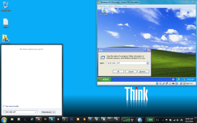

Hi All ,
I wanted to access some content which have been shared with the network in a SAMBA server. SAMBA server is working fine. I am able to access SMABA shared folder from my Windows XP box.
1. SAMBA server is in FEDORA 14 box and connected to wired LAN. (Broadband switch)
2. Windows OS's are running in my laptop. Host OS is Windows 7 and I have installed Windows XP as a guest OS in the Virtual BOX.
3. So , my Laptop access the network via WiFi.
4. All PC are in a common IP network. (192.168.1.*)
5. Fedora - 192.168.1.107 , Win 7 - 192.168.1.106 , Win XP - 192.168.1.105
Test Results
1. I am able to access the SAMBA share from Windows XP ( Installed in a Virtual Box )
2. But unable to access SAMBA share from Windows 7 ( which is my laptop's OS )
Please find attached image of the same.
I googled and found so many articles regarding this issue. But non of them are helped me to solve this issue.
Could you please help me to resolve this SAMBA share access issue from Windows 7 ?
Many Thanks
Luke.

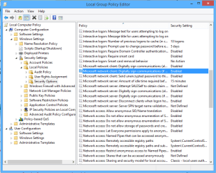

Ok try this.
In the Local Group Policy Editor, go to: Start>run>type gpedit.msc
Local Computer Policy->Computer Configuration->Windows Settings->Security Settings->Local Policies->Security Options
Find the policy:
Microsoft network client: Digitally sign communications (always)
If this setting is enabled, change it to Disabled then hit the Apply button. On my Windows 8 machine this setting is Disabled by Default but that may not be so on Windows 7.
There may also be another setting for this "highlighted in blue" that shows "if server agrees" in the picture which may need to be disabled as well. You must reboot both the server and the client after making the adjustments.
Another possible solution if the first one doesn't work: Computer Policy->Computer Configuration->Windows Settings->Security Settings->Local Policies->Security Options
Network security: Restrict NTLM: Outgoing NTLM traffic to remote servers ALLOW ALL
