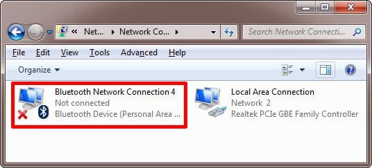

Neither my android phone nor my Oontz Angle 3 speaker will be recognized by Bluetooth in my Windows 7 Professional 64-bit computer. When I click on 'Add a Device' in the Bluetooth settings none of these devices can be found. When I check the adapter settings in the Network and Sharing Center, the Bluetooth Network Connection is not connected, and has a big red X on it. I suspect this might be the source of the problem, but I can't figure out how to connect this Bluetooth adapter. Does anyone have any ideas?

I see the same thing but it doesn't matter because Bluetooth works anyways.

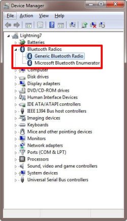

Do you see Bluetoooth in the Device Manager OK?

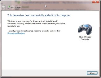

Here is how I just added my Xbox One Bluetooth controller to my PC
1. I started pairing mode in the Xbox One Bluetooth controller
2, I located and selected it in Add Device to computer

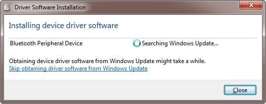

3. Windows searched for a Driver

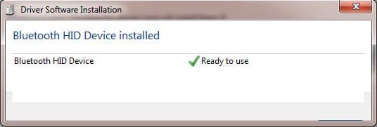

4. Windows found a Driver and loaded it
5. The Device was successfully added to computer
6. The Controller can now be seen in Devices
