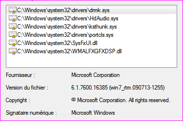

My prob is, i'm either a computer based support Hdcp through Hdmi plug. The first time i'd got the computer, i plug it onto the Hdmi to a HDTV (don't think Tv is Hdcp compliant) and it of course the Audio sound switched to HDMI. I went to the parameters to config the properties of HDMI output and saw that was displaying "Hdcp capable" in the connectors information. Played my dvd at 1080p with no probs at all as it wasn't a Blue ray disc.
Later time done exactly the same with another dvd, but in the mean while updated the graphic card from the manufacturer drivers...and it says it wasn't "Hdcp capable" Compressed driver no found anymore in the Hdmi properties.
Thought it was the driver update, so revert it back to original, but still the same. No big matter.
So, anyway as i'm not using it with blue-ray disc at the moment, let it for a while and updated the Graphics Card drivers.
I was wondering if do insert a blue-ray disc with Hdcp compliant materials, it will be back again in the chain.
One thing i noted is that i've got only Microsoft drivers listed (see attached thumbnail) as it was provided with the computer.
Looks missing in it the HDaudBus.sys (it is present in System32\drivers!!) and when i do update the driver it won't load... but looks it triggers anyway when it needs and is started.
I know either i can install some ATI HDMI drivers (got a M-Radeon Ati HD Card), as some are doing & saying they do works better than MS one.
Any of you had this one prob? No hurry!
