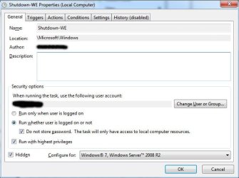

Sorry to jump in here. Not meaning to detract from the help that has already been provided, but I'm sure I don't have this this issue. I have tasks running regularly across multiple W7 computers and the DOS window does not flash up on any of them.
I achieved this using the combination of settings as shown on the attached image.
Tanya

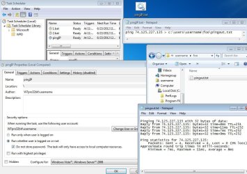

Am I missing something in the OP's request?
W7 Pro SP1 64bit
i7
8GB
Intel HD Graphics
crappy SSD
........Is there a way using a VB script to do a ping of a IP address and send the results into a file?.......
I'm not sure if you had the same requirement of hiding the command prompt window on this request too, but if the actions/settings shown in the video that I posted above do indeed hide the command prompt window for you then a simple batch file with
ping google.com > c:\users\username\foo\pingout.txt
or
ping 74.125.227.135 > c:\users\username\foo\pingout.txt
should do what you want
