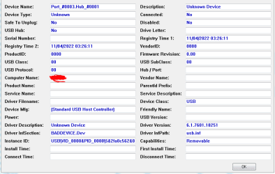

Here is more info from devmanview
Full instance ID is USB\VID_0000&PID_0000\5&2fa0c562&0&3 btw
And the funny thing is that in the Windows' device manger it sees the device as
"USB\VID_0000&PID_0000\5&2fa0c562&0&4" which belongs to Port_#0004.Hub_#0001 instead of "0000\5&2fa0c562&0&3" and Port_#0003.Hub_#0001
