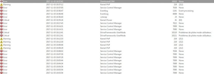

Ok I had a look in event viewer just now. This was right when I booted up after coming back from work, pc shut down for hours. This is when it took forever to log on and didn't work. It's mostly timeout errors, one is about cdrom, rest about multiple programs like Kaspersky, Skype updater, Malwarebytes and such.
