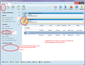

Thanks ICit2lol, will give them a bash.
I have noticed that it seems as soon as I transfer fresh drivers from my USB to HDD those programs will become unstable within minutes. After the 5th time of installing OS7, I quickly ran my Graphics driver and in installed, but like always catalyst control crashes upon reboot - even when the PC ran fine, but at least the driver loaded - can't do jack on 1024X768 on a 27" LCD.
I'm afraid that my media may be heavily contaminated - based on what I'm observing. And it seems any new media I expose to the PC gets corrupted in no time.
I will try a few swipes with the above mentioned programs ICit2lol. This will take me a while to do though.

Thanks for the update ICit2lol, got them now.
What I'll do is the following, feel free to advise:
1. Gonna test all current HDD's connected onto the MOBO with Mentioned Programs above.
2. Conduct a thorough Virus Scan with above mentioned as well.
3. Use new SATA Cable connector.
4. Install OS7 on spare drive - with no other HDD's, just to ensure cross contamination is eliminated. If Drivers and soft runs at this stage, I will gradually add 1 Media HDD on to the system and see if anything happens after reboot between HDD add-on.
