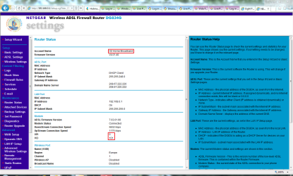

Can you enter your router configuration? This, from my router's configuration page, shows the information required (outlined in red).
All personal identifying data obscured.
