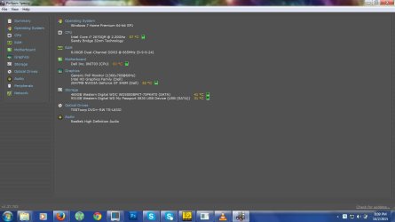

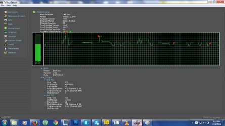

I cleaned up the vents etc .. and its still overheating and ... it causes freezes at random temperature ... screenshot attached with red marks(red marks=freeze)
This freezes last like 1sec but its quite annoying as it happens randomly but within every min or two.
Anyideas?
And CPU heat seems to be stay around 50-59 .. but motherboard it pretty stays above 65
Also I created a speccy snapshot taken right after freeze(in case it helps), here is the url: http://speccy.piriform.com/results/acXc44unnfux72WRJ3nRGAl

This is rather strange .... I did some extensive research and found this article ... dell xps l502x freezes making buzzz sound while playing audio or video file - Laptop Audio Forum - Laptop - Dell Community
It seems those 2 software are the culprit, after uninstalling them this freeze issue stopped for now, I'll keep it under observation for next 24hours and see how it goes.
Now that one issue is probably resolved, anyone have an idea as to how can I keep my systems temperature down? Its quite jumpy ... even when using vlc player with 480p video .. and pretty much nothing else running .. CPU temp stays at around 59-75 C ...and motherboard about 65-90 C.
