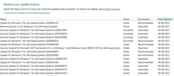

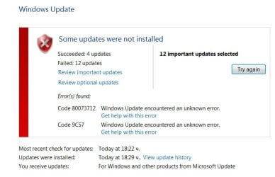

It let me update a few more updates, but more still failed.
I'll try apply all updates and I'll let you know.
built
Windows 7 Professional 64 bit
Intel Core 2 Duo E8400 3000 Mhz
GeForce 9600 GT
Nope,
attached are error codes and updates which failed.
rgds

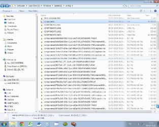

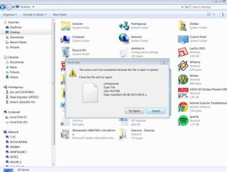

Now it does not allow me to either copy or zip it. It says it is open in system...
See attachments.
Should I try and copy it in safe mode? Or this indicates some other problem?

Boot to Safe Mode, and do the copy there.
