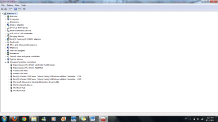

Here is the requested screenshot:
Windows 7 Pro 64-bit
Something is wrong but I am not sure how to fix it. My understanding is that you need a Root Hub for every Host Controller. You have no Renesas Root Hub installed. I will see if I can find any info on this. You could try removing and re-installing the driver.

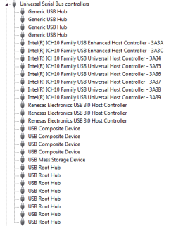

I'm not certain that mine are right, because I don't use them yet, but I have two NEC host controllers and two root hubs in the Device Manager.

Not sure how helpful the picture will be but here it is!

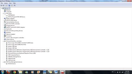

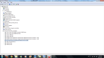

I have a similar problem. My Western Digital My Passport isn't able to connect through my USB 3.0 port, but works fine on any USB 2.0. Other USB 2.0 drives work on that USB 3.0 port too, so I'm not sure what the issue is. Attached are screenshots for the different scenarios.
I checked your motherboard specs you have listed for your system and the Biostar TA785G3 does not appear to have USB 3.0 ports only USB 2.0. Is this the correct motherboard or do you have an add-on card and if so what make and model?
▲This - the specs for that board are x4 USB 2.0 ports - no mention of USB 3.0
If it's the correct board and you have an add on card, have you installed the drivers for it?
