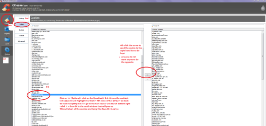

No probs mate the HW is very small and very handy the other PSU stuff is good for checking out the rail volts too if you suspect them as Scott Mueller points out they are more of a problem than people give it credit for so always one thing I head for usually.
My ride now is one of or probably the best car I have ever owned / driven a 2011 Mazda 6 sports hatchback re sporty and more important to me a great fuel economy (and Bose sound system).
If you haven't seen this http://www.sevenforums.com/tutorials/11728-optimize-windows-7-a.html it is my bible and the authour one of the greatest fellows I know and it will speed up and make your machines run more efficiency - if you don't mind losing some of the "bling" like transprancy.
Another if you haven't got it already is this CCleaner - Free Download - Piriform download only from piriform unless you like nagging LOL!! One tip though once you have run Analyse > Options > Cookies > and click on the sites you use with passwords - it will highlight and then click the arrow in the middle to send it to saved cookies on the right hand side or you will end up having to login on those sites.see pic
Anything else just ask.
Oh meant to add install this https://unchecky.com/ < stops those wretched add on things like the Ashkbar, Google toolbar etc
John:)
