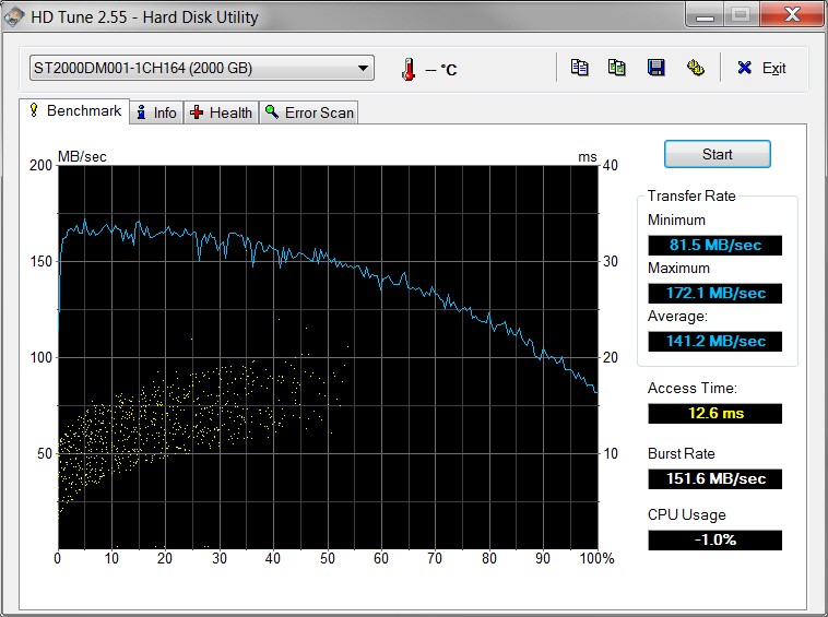

If you use a program such as HD Tune (free or Pro) you will see the actual internal hard drive details (i.e. manufacturer and model) that's inside your external USB enclosure. If you then do a search on that drive id you'll see whether it's a really cheap or slow (or green) drive, which immediately is going to limit its performance even when using USB 3.0 connectors.
Just for example... I have two Verbatim Store 'n' Save 2TB external USB 3.0 drives on my PC. Actually I've installed probably 10 of these drives (as backup drives on other machines for friends and family) over the past few years. Now even though these all purport to be from Verbatim, in fact every single external drive I've purchased has included a DIFFERENT brand/model of SATA drive inside it, starting with Samsung SATA-II drives, moving on to Seagate SATA-III drives, and most recently using Toshiba SATA-III drives.
Anyway, these two particular Verbatim drives are both Seagate inside... although two different drive models. Both drives are connected to the rear Intel USB 3.0 connectors on my P8Z77-V Pro board. And as you can see from the following screenshots from HD Tune (which show the particular Seagate drive model for each), they both perform differently.
In contrast, another Verbatim drive (this time with a Toshiba drive inside) in use by my Lenovo W530 laptop via its Intel USB 3.0 connector performs differently again.
Bottom line: all external USB 3.0 drives are NOT the same. But at least using an objective performance measuring tool like HD Tune can easily demonstrate what you should expect... in best case.
