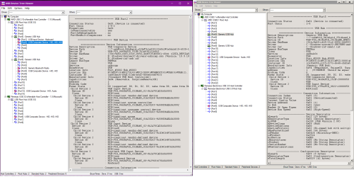

USB devices plugged into hubs on my Windows 7 install (see right) are no longer showing up on the hubs on the AMD controller. What's bizzare is that the devices still function for normal desktop use. However both VirtualBox and VMware fail to detect anything plugged into the hubs. It used to work correctly, but it doesn't anymore.
The window on the left shows what it should look like, as Windows 10 is still working correctly.
I've tried removing, deleting and reinstalling the USB drivers (for both the controller and root hub) and reinstalling them. No luck. i've been unable to find any other versions of the driver that support the controller. Any ideas?
The USB controller is:
AMD USB3.1 eXtensible Host Controller
PCI\VEN_1022&DEV_43D5&SUBSYS_11421B21&REV_01
The driver is:
amdxhc31.sys version 1.0.5.3
The driver is:
Windows 7 x64Core i78GBGTX 560
