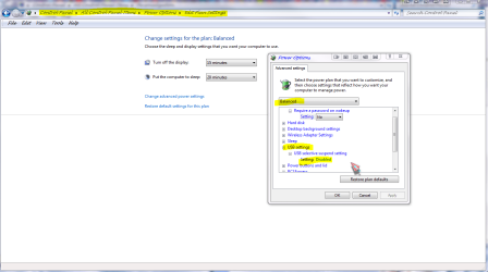

When waking system up from sleep state with knocking USB keyboard key - sometimes (pretty frequently) the system wakes up but the keyboard is deadlike - cannot type logon password, cannot ALT-CTRL-DEL, nothing.
That never happens when waking the system up with power button.
Any idea what is wrong???

hello and welcome to the forums:) i had the same problem(http://www.sevenforums.com/hardware-devices/110084-keyboard-not-resuming-pc-sleep.html) and i solved mine by changing the the usb settings in power settings.
OK - I apllied changes USP power setting as on your screenshot.
Now I am working, Iwill know how it's done after a few sleep/wake-up cycles.
Thanks a lot!

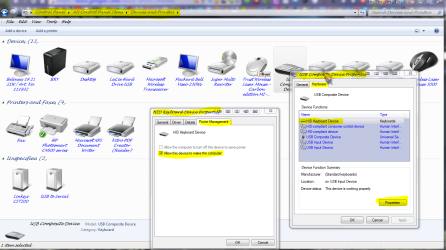

also i forgot to mention check your keyboard properties (and mouse) for *enable this device to wake from sleep* (or words to those effects)
