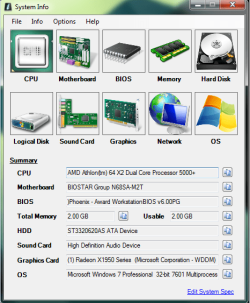

Here are my system specs.
Windows 7 Professional

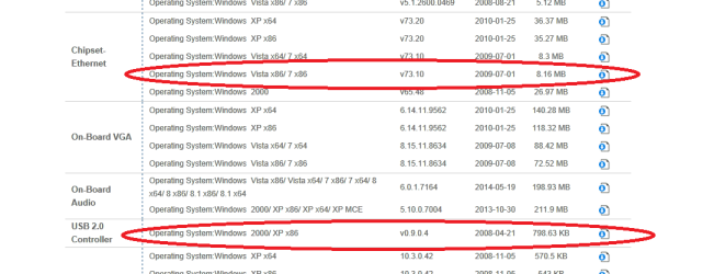

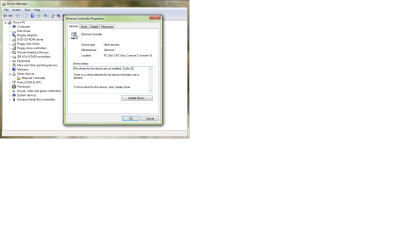

Ok Loganus this seems to be a much older board than I expected and maybe the ports are just worn out - I have no way of telling that except by looking .
What you can do is to download the USB drivers from this site - it says XP but they are the only ones available as you will see and you could try the chipset - Ethernet but make sure you download the correct bit one (I have circled it in the pic)
http://www.biostar.com.tw/app/en/mb/introduction.php?S_ID=498#dl
