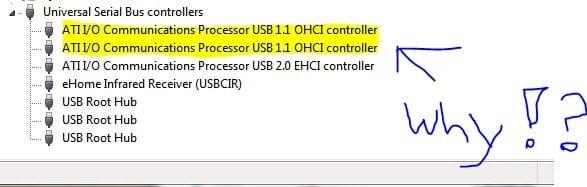

They were all recognized in vista as 2.0 and worked fine. So this has to be a Windows 7 bug or something. In looking at the device manager I did notice this which is quite aggravating... (see pic)
I've tried removing them all and letting windows re-recognize them. Nothing changed... (Upon trying to uninstall the 2.0 one... I get BSOD, EVERYTIME)
I've tried going manually to make the 1.1 ones use the same 2.0 driver as the other, this did not work either.

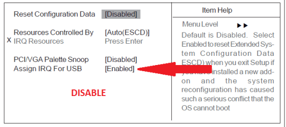

I am fishing. But let's start in BIOS.
I think I've tried that too... as a matter of fact I think it's set that way right now... I'm going to reboot and make sure though.

Right Click ACPI Fixed...
UNINSTALL
On the Menu Bar,
Scan for hardware changes
Let Windows re-install the device.
No Luck
Tried that... Still nothing has changed.

The yellow line indicates there are no drivers available for this device - go to your motherboards site, or intel, or AMD, and download the latest vista chipset drivers for your your motherboard - if they wont install because of an OS mismatch do the following -
To install a driver OR program in compatibility mode - right click the setup.exe file - click properties - click compatibility - check run in compatibility with vista - check run as administrator - leave the rest blank. Start setup.exe and install.
