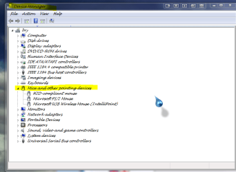

Hi!
As far as I remember this started to happen few weeks ago, or so. The mouse hangs a second or two, than skips, and after that it works ok for 10-15 minutes. When the mouse hangs there is sometimes a USB plug or unplug sound, but this sound is also hearable sometimes when the mouse doesn't hang. This happens in windows, but also while I play games.
I can hear this sound also when I plug/unplug the monitor cable to/from the graphic card. Also, this sound occures every time when I replace my graphic card driver with newer one, but only fitst time, right after the windows restart.
I know I can turn it off in the system sounds, but that's not the solution I'm looking for.
I checked the cable, and pluged the mouse into another USB port, but that didn't change a thing.
I even reinstalled Windows, but the same thing happens again.
Also, sometimes when i turn on the computer I have no sound. In volume mixer the Speaker disappears and I have only SPDIF out (I don't use it). When I reinstall the drivers it works again for few days.
This happened on my old config, too, but only 2 or 3 times in few years, after the nvidia graphic card update and computer restart.
You can see the full details about my config in system specs.
Regards and sorry for my English.

Hello again!
In last two days I was trying what you suggested. But nothing helps. :(
I did the SFC Scan but it is ok:
Windows Resource Protection did not find any integrity violations.
Then i tried to delete and reinstall the mouse and the sound driver, but no go.
Unfortunately I have no other mouse to try.
Also, I noticed that in the Volume Mixer the settings are reseted to their default values every time when this unplug sound happens.

Reinserting the graphic card and reinstalling the drivers didn't help. Cannot update the USB drivers, it says they are up to date already.
But I found the USB-PS/2 adapter that I got with the mouse. Now with it there is no problem for almost a day. Except that the tilt buttons don't work this way. :(

It was the NVIDIA HD Audio driver.
After intensive googling i found this thread:
Q's: GeForce 460 with HDMI Audio Out - NVIDIA Forums - Page 2
The guy has the same graphic and sound card and has the same problem.
Since I uninstalled the HD driver, no more sound disappearing and mouse freezing. The mouse is not faulty, after all.
