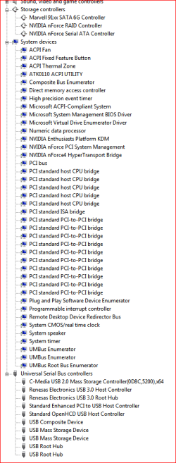

Thanks for the advice.
1) the system does recognize the card and has a driver for both Marvel 91xx SATA 6G controller and for USB (see attached devices.png)
2) The mobo manual list "Other PCIe devices (X8, x4, x1)" under non-SLI mode
3) The problem is that I cannot use my second monitor in this configuration (i.e. under win7 64 ultimate SP1; the same setup will work under XP 32bits):cry:
4) have to admit that my old mobo is not on the U3S6 compatiblity list (see e.g. Asus U3S6 USB3.0 weird quirks - Other-Components - CPU-Components however, it evidently is compatible enough to work...
So, I'm not prepared to give up yet and still believe it is a win7/driver issue. I don't suspect the nvidia driver terribly, since a similar driver will work under xp. But I did post on Nvidia as well, no luck so far.

A strange test perhaps.... You state that your main monitor does not function correctly in W7 with that card in. It wont go past BIOS. Have you tried booting in Safe mode with th card in? I know your second monitor won't show... But it would be interesting to see if basic Safe mode W7 drivers do let the monitor and card combine....
Tried it, they do combine in safe mode. The USB 3.0 Host Controller utility recognises the card and the primary monitor keeps working.
Flashed the bios to the very latest, too (was asus 5001, a bêta, now 1103).
After normal boot, no change though.
I'll check again for the latest Nvidia gpu driver, did the last one like a month ago.
Still a puzzle to me..
Jan
