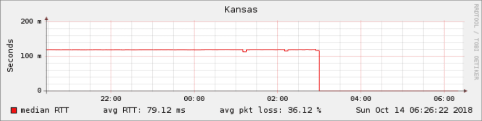

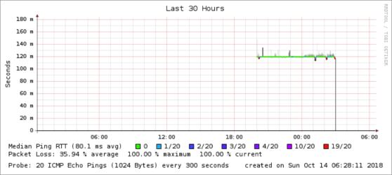

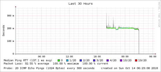

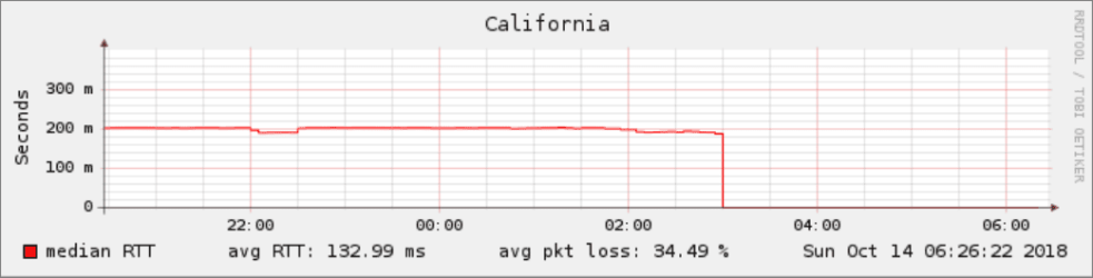

Smokeping needs to ping your router. That's why I told you that you need to go into your router and allow pings. You only do this for 24 hours, then you can block pings once again. It's really not so much of a problem you need to worry about in terms of being "hacked." It's just a ICMP packet sent to your router and your router responds back. The great thing about Smokeping is it will indicate whether you have a bad line or not.

I started a Smoke Ping test.

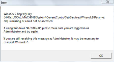

Check if there are any LSP hooks. LSP-Fix - a free program to repair damaged Winsock 2 stacks
LSP Fix gives that error message :
That's strange. I have just "reset" Winsock three times. Once with those instructions, then with TCP Optimizer 4, and finally with ADW Cleaner.

4. Quality of the DSL phone line
Here are some more data :
Smokeping from California
Smokeping from Kansas (or Virginia -- says both)
I don't have the slightest idea what the above means, but we know my phone line is not very good.

5. Winsock troubles and associated Windows malarkey
I went through the Microsoft Support link you gave me. This Samhrutha G guy there points the OP to another thread, which has a manual diagnostic for Winsock integrity, and remedial actions.
The remedial action is the famed netsh winsock reset command, which I have already applied countless times.
I nevertheless went through the diagnostic steps. The diagnostic failed (if the advice is correct !), but the remedial action did nothing, just as it did nothing before (nothing durable, anyway).
The alleged Winsock corruption diagnostic comes from a list of items under System Information / Components / Network / Protocol being incomplete. The list should allegedly have 10 items or more, but I have only 8. This is bad, according to the Microsoft Support article (which does not pertain to Windows 7).
However, another poster (an MVP, no less) says his Windows 7 64-bit has the same 8-item list as me, and everything is normal (I'm on 64-bit, too). Added to the fact this is a piece of advice referring to another piece of advice, given by someone else, and that it's in fact meant for Vista, not 7, but it's just supposed to work as well for 7, according to the guy Samhrutha G who did not give the advice in the first place, I'm inclined to take the whole thing with a huge dollop of salt.
My Windows install is not in a nice shape, that's for sure. It misbehaves in all sorts of ways (slowness, etc), but then that's the nature of a not-just-made Windows install, isn't it ?
Any ideas ?

Okay, your router is most likely fine, if it was hacked it's gone, no malware it seems. So moving forward I'd say your Windows installation is corrupt in some fashion. Have you tried a sfc /scannow in an elevated command prompt? If it fails to fix anything, you may need to do a repair install which means you need a Windows 7 disk for the current version of Windows 7 you have. Especially troubling is that you now say there is slowness and what have you which is defiantly not normal.
Your smokeping results show packet loss to your router which does indeed mean you have a bad line. Whether this is the reason to your 2FA issue I don't know. I do have my doubts.

Solved - Internet cabling was bad
I wanted to report back on the situation, and thank you, F22 Simpilot, for your help. The issue has now been solved, and the Internet connection was at fault.
Incidentally, I ran scannow, and everything is fine on that side. Tutanota disconnecting itself, when I was trying to send mail with only tiny attachments, had nothing to do with my side. Tutanota assistance finally told me that it was a bug on their side, and that it has been corrected.
I did two things :
1. Sent my router away from my desk, to the other side of the house, next to the phone plug, and replaced the 15 meter, unidentified phone cable running the distance, by a certified, Cat-5e, 100 % copper Ethernet cable by Monoprice. The ADSL filter moved away from my desk to the wall phone plug.
This put an end to Verified by Visa disconnecting the computer from the Internet. It also increased the connection speed, as shown in various measurements, although it wasn't yet perceptible.
2. Changed my DNS server from default (presumably, my ISP's) to Cloudflare 1.1.1.1. This boosted speed a step further, and this time, the difference was obvious to the naked eye (and it was reflected in figures, too).
