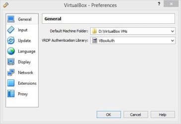

Favorites will write to wherever your users folder is so if Vbox is running on D: then that is where Vbox will write.
Mine writes everything under D:\VirtualBox VMs because that's where I told it to write.
Check and set this via File, Preferences, Default Machine Folder:
