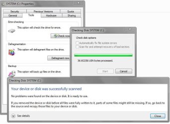

  1. Perform a Disk Check | http://www.sevenforums.com/tutorials/433-disk-check.html
  2. Then Post the results following | THIS METHOD

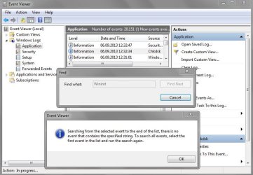

I've done YoYo155's steps 1 & 2. Here are the results:
View attachment check disk system log.txt

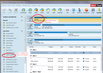

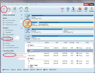

The Partition Wizard I referred to in addition to the physical surface testcan open up those files using the explore button to see what you have got but Iam guessing you know what you want.
Now to clone the drive you will need some sort of hook up device and I use aUSB to SATA gadget all the time.
So if you decide to clone to a new drive or even reinstall using thetutorial on that you will,need to get one of them. They are not expensive andalso if you decide to re install using the tutorial and your activation code asper that you will get rid of all the bloatware and then drag the data back formthe old drive via the gadget.
Sounds complicated but really isn't.
Have a lookat the tutorial and see what you think. http://www.sevenforums.com/tutorials/1649-clean-install-windows-7-a.html
Have included some pics of the test and the gadget it does come in differentforms depending on the barnd.
The clean install you will just need to install the new drive and boot fromthe media you make with that tutorial. The like I said copy the data from theold drive which would be out sdie the machine via thatgadget

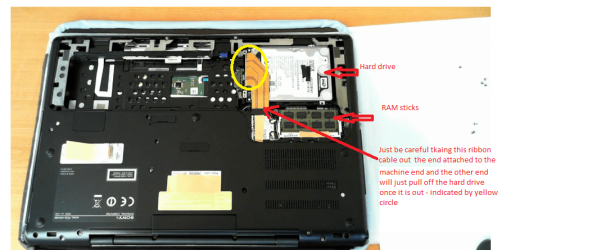

Sorry late reply Brato mate take a look at this video unfortunately no audio but just follow what the fellow is doing up to when he removes the hard drive - then stop - do the hard drive change over and just reverse the process. Your machine should look just like this if not very similar.
Sony Vaio SE disassembly - YouTube
Just keep in mind the ribbon cables are reasonably fragile and require gentle removal. Once out just unplug that cable to the original drive and attach the new one and like I said reverse the process in the video. (and see my pic)
A tip mate make sure the power supply is removed and the battery and I always place the machine on a large bath towel preferably - white - spread out in case you drop those small screws. The towel will stop them on the spot if you drop them on a hard surface the screws have a nasty habit of bouncing off the top onto the floor to be sometimes lost forever:(.
Also a good idea is to have a small pot to retain them and count them too.
If you have any concerns at all please post back and ask us.
