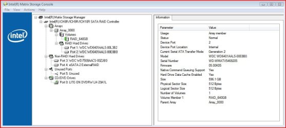

Here is what I have in mind after reading up. You (please) tell me.
I run Vista x64 very nicely on my home build system, Rock solid. I am very curious about 7 but my Vista is not broke if you know what I mean.
I have a job coming up to run a new beta on windows 7. I will have an OEM Windows 7 Pro copy.
I want to run 7 and the beta, all alone on a brand-new HDD, a WD 640GB AALS single drive.
My current Vistax64 system runs on the exact same make and model HDD but in RAID1.
Being new to dual booting I want to make sure if the beta gets nasty it will not effect my Vistax64 system.
If I read correctly, it looks like...
  1. I install the new HDD.
  2. Boot to the win 7 CD/DVD.
  3. Choose to create/delete or what-ever in order run on a single partition on the NEW HDD. A new HDD should not need any partition work correct? The installation will format and allocate the HDD correct??
  4. Now when I boot the default system will be 7 because it was installed last but have time at boot to choose 7 or Vista, or do an F12 and choose, Correct?
  5. Now I need to read up on how to make the Vista64 the default Booting OS in the event the boot is unattended. You got link?
I have included a pic of my port setup so you guys may look ahead for me for optimization.
  • Ports 1 & 2 are my Vista x64 OS dual RAID1 drives.
  • Port 3 is a stand alone 750GB storage drive.
  • Port 4 is an external eSATA box with a dual 750GB drives on it's own RAID1 controller. It's just a single eSATA cable from the box to the board.
  • Port 5 will get my new HDD for Windows 7.
  • Port 0 is my DVD/CD
(Months Down The Road) Here is where I want my cake and eat it too. When the beta is done and I decide I love 7 now and want to migrate all my stuff to it. I will want to run it as a RAID1 array. I guess I can Pull all HDD's, put the 7 on the main port. Format one of the original Vistax64 HDD's and ...........?
Thanks For All You Do!

Bump Up! How about it guys? Will putting the new HDD on port 5 be OK?
Does it sound like I'm going to do good?
Should I install the drive and do the allocation thing with a full format then install 7?
Thanks.

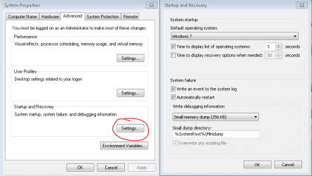

That sounds fine. You do know that the Windows 7 betas have expired, right?
To set Vista as the default OS, see here:
