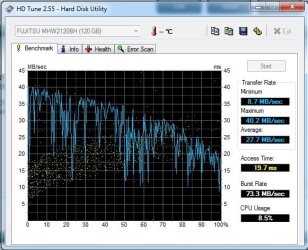

Here it is... hope someone can offer some help. Thanks in advance.

Alright. That's a 5400 rpm drive which is not geared towards high performance. Ouch on that 8.7 MB/sec minimum speed and 27.7 MB/sec average. CPU usage is low which is good. Burst rate, however, seems surprisingly good for a 5400. Access time, eh, not so good.
Unless there is something wrong with drivers which at this point I'm guessing not, there is only one thing you can do.
Get a hold of O&O Defrag and use it to defragment the drive. Alternatively, you may use Windows built in defrag. I'm willing to bet that the drive is very fragmented right now.
Let us know how things are after you've done this. If it is still quite bad, I and others will have ideas for you.
I went ahead with the defragmentation through O&O. The drive was only about 3% defragmented, but I got it down to 0%. It did seem to alleviate some of the effect moving/copying had on system performance, but the speed of transfer remains low.
If anyone else has any other suggestions or tips to improve or help with this issue, it would be greatly appreciated. Thanks again to everyone who volunteered to assist me.
