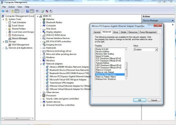

go to device manager and find your lan in the list. then go to advance option and find the wake on magic packet, turn it on. then go to your bios setup. it must have the wake on lan option to do so. if had, enable it and thats over.
run the wol i sent you and your computer would turn on by a magic packet.
