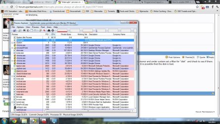

Using Process explorer I found that Interrupts is the one I should me watching!
Searching a little bit I have found that problem could be in ATA Channel, that it can be switched to PIO mode, but on mine, it says that DMA is enabled!
Also, when waking from sleep I hear that sound like when you remove USB from PC, even thought I haven't removed anything...

Well, interrupts (and the system process) would indicate a driver issue or a system configuration issue, but it's unfortunately not easy to tell from a process explorer snapshot. As I said initially, my suspicion is a networking issue, but all of the "easy" tests sort of dispel that.
Let me think about what to do here - dumping it hasn't been successful, but more info is good. Let's see if I can come up with something that'll spill the beans, so to speak, that we can do here.
