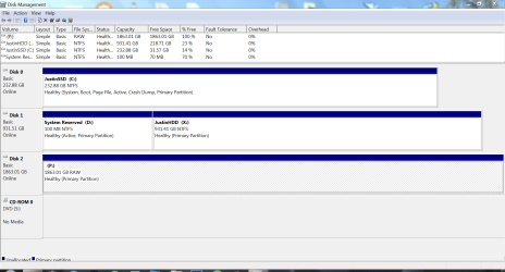

1.Post a fresh screenshot of Windows Disk Management. Close Windows Disk Management.

Yeah those screenshots are after a restart; however, as requested, I've rebooted again and added new screenshots.
Diskmgmt

What do you have on your 250GB SSD and your 1TB HDD? OS and bit version. Your 1TB HDD shows a system reserved 100MB partition.
Where is PW installed?
I hope that the PW screenshot and Windows Disk Management are from the same OS.

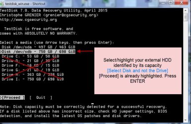

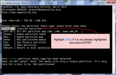

Third Screen:

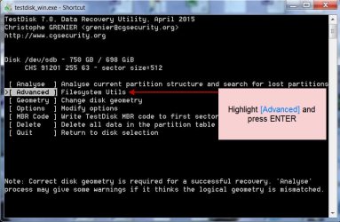

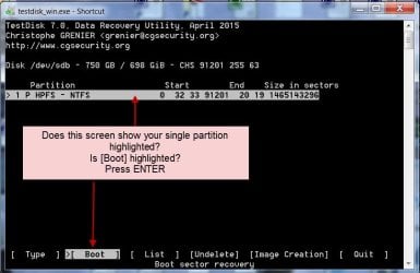

Fifth Screen
NOTE: On this screen as well as the next screen you can highlight
  • using left/right arrow key and press Enter to see the files. But right now we shall not do it. The aim is to check whether there is any filesystem deficiency which can be corrected. If the deficiency can be corrected the whole drive can be recovered. If the deficiency is beyond correction, then only we will use List to see the files/folders and try to copy those.

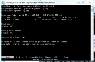

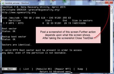

    Sixth Screen:
    Post this sixth screenshot and close TestDisk. Let me examine it and decide what is to be done further.

Thanks for that. Here's the screenshot of the 6th part.

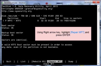

OK, both Boot sector and Backup boot sector are OK. Now repeat till you again get this screen, Move the Highlight to [Repair MFT] and press ENTER
Post a screenshot of the resulting screen showing the MFT status. After that close TestDisk.

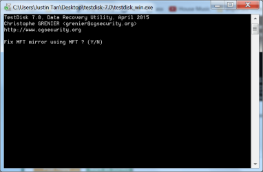

OK, when you reach this screen Press Y and let TestDisk fix it. Let me know what happens by posting the resulting screen. I am online to give further instructions. So do not close TestDisk.
Post the screenshot and wait for my instructions.
If I do not respond within half an hour close Test Disk.
Windows 7 Home Premium 32 bit
I accidentally closed it before taking a screenshot but it said it MFT fixed or something like that then when I tried going to the same thing I got this new message.

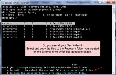

RunTest Disk.( It should now show all the drives including your destination drive) Go upto the fifth screen in my post #6. Move the highlight from [Boot] to
  • and press ENTER.
    How to copy the files to the Recovery folder on the Destination Drive:
    See my post #28 here My external hard drive suddenly became unllocated:
    Follow the procedure outlined from screenshot 5 in that post which is akin to the second screenshot in this post.
    : to select the current file ( Shift+: )
    a to select all files: a is lowercase. Just press Key A
    C to copy selected files: C is uppercase (Shift+C)
    c to copy the current file : Lower case Just press Key C
    When you have finished copying the files, check the integrity of the files.
