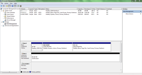

But before that I would like to see the following two pictures. Take the screenshot with only the faulty drive plugged in. Remove all other external drives/pendrives/USB hubs/ docks/USB printers. Nothing else on the USB ports except the USB Keyboard/Mouse.
1. Windows Disk Management. Follow the guidelines here to post an untruncated screenshot with all the information available http://www.sevenforums.com/tutorials/274797-disk-management-post-screen-capture-image.html

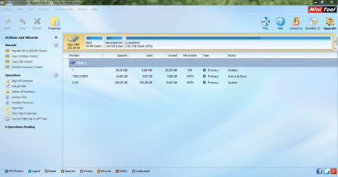

2. Run MiniTools Partition Wizard and post a screenshot showing the drives - the first screen that appears as soon as you launch PW.( You said the drive does not show up in PW. (?) Anyway try again and report.)

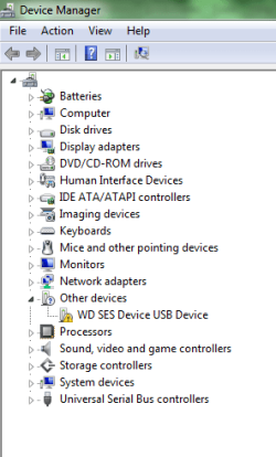

EDIT: Post a screenshot of Device Manager too.Let us get the nomenclature of the drive. That should help CKWD tell us whether your Passport is hardware encrypted. If it is hardware encrypted, there is no point in cloning the drive and running the data recovery on the cloned drive - a procedure we adopt on a drive with bad sectors.
Windows 7 Home Premium 32 bit
Jumanji, thanks for the follow up. Below are the screenshots you requested. I noticed too that while the drive still doesn't show up in Explorer, it is still listed as an open drive I can "safely remove." I'm assuming that has something to do with your first post and the firmware. As you can see with MiniTool, the drive doesn't even show up. I'm not sure why and I haven't yet tried it on another computer. Going to try Peppermint momentarily. Got too busy to try it yesterday and thought I'd go at it after some sleep.

In Device Manager I wanted to see the disk nomenclature. You should expand Disk drives so that we can see what drives it shows. Similarly also expand Universal Serial Bus Controllers and check whether the drive is represented anywhere there. Post a fresh screenshot. But one thing sure is that that there is an exclamation mark On WD SES Device USB device. Let CKWD see it and advise you as what you should do. (I am not that familiar with WD drives. WD puts some special requirements)
Apologies, Jumanji, I misunderstood. Here's a more detailed screenshot. The USB issue is related to not recognizing the drivers. I had read that un or reinstalling them can make things worse if it's a hardware issue where the drive doesn't automatically install the proper device. If you or CKWD want me to try it, I'll be more than happy to. Thanks for the fast response! I won't expect a reply for a day or two from CKWD, but I'll check back periodically just to check.

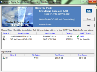

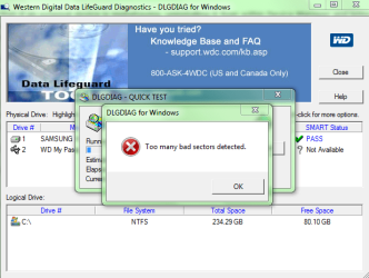

Lifeguard sees the drive, lists the SMART Status as Not Available, and as you suspected, a Quick Test fails. I've attached the screenshots.

The doctor's diagnosis unfortunately is that the drive has developed too many bad sectors, as seen on the second screenshot, showing the Quick test error, and additionally, it obviously has a hardware problem, judging by the description of the sound you gave, although I already suspected it. :/
All of this means that the drive is too damaged to be tested by a software or fixed by yourself. My advice still remains to use professional data recovery help for your data, as anything else could further damage the drive and make the data more irretrievable.
