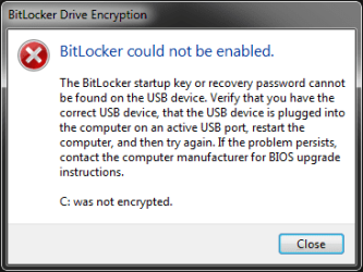

I've followed those steps, and at step 5, after I do the Run BitLocker system check the error comes up..

Attached is an image of the error

No way to suspend or resume it at that stage.. After that window is closed, need to restart from the beginning.

So you have yet to get bitlocker setup?
