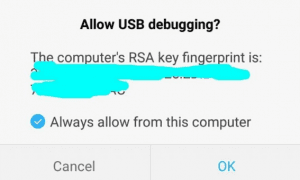

I investigated the ADB program. At How to Install ADB on Windows, macOS, and Linux, I am stuck at step 7 of the instructions for windows. I do not receive any kind of pop up in my phone.
[SUB]I did not install it: However, I have a strong hunch that you misinterpreted my desire to interact with and debug the phones. I need to get the information (or ACPI table?) from the PC directly.

We already do that at step 5 of setting up the phone.
What I don't get is this:
btw I didn't do ./adb devices. I typed adb devices.
Something about a key is missing (perhaps the adb server needs that?)

In step 5 it says, " file transfer (MTP)” mode."
Is it in this mode?
You won't be able to send any commands to the phone via ADB and CMD prompt without FIRST making sure you have a link (a USB or WiFi link). Once that is settled you can move on to issuing commands via ADB.
And it looks like you may need a driver. I posted this link in my first post and that's where I learned you may need a driver.
https://developer.android.com/studio/run/oem-usb
Samsung Android USB Driver | Samsung Developers
Make sure you read all.
- - - Updated - - -
The key (RSA key) is missing because the link is bad to even give you that option for acceptance.
Is it in this mode?
Yes, I have set ti to MTP.
Well, the file explorer already shows the phone.
I followed the first link, it didn't mention a driver. I also visited this link but I was following the steps there (section before the steps didn't mention a driver. I will check these.
- - - Updated - - -
I installed the Samsung OEM driver and it worked
Screenshot_2022-05-15-21-05-00.jpg.
So, the computer is not connected to the phone correctly, right. But the USB connection is all well.
