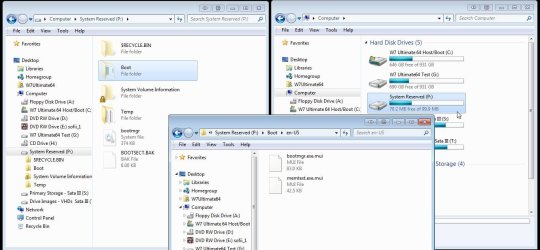

I have it and then I don't have it! :D It was on and now it's not having just finished up another clean install of 7 here.

I'm a little confused between and have not.
A post of diskmangement display of present system would answer whether you do or do not have a 100 MB System Partition.
