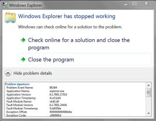

Here's the error message:
Problem Event Name: BEX64
Application Name: explorer.exe
Application Version: 6.1.7601.17514
Application Timestamp: 4ce7a144
Fault Module Name: ntdll.dll
Fault Module Version: 6.1.7601.24441
Fault Module Timestamp: 5cb9356e
Exception Offset: 0000000000089e6e
Exception Code: c000000d
Exception Data: 0000000000000000
OS Version: 6.1.7601.2.1.0.768.3
Locale ID: 1033
Additional Information 1: d6af
Additional Information 2: d6af87578f59531a48b8b10c6d515ca6
Additional Information 3: 419c
Additional Information 4: 419cfd3a806b584e46cfdd69003d826d

Exactly the same problem here.
However, I have different version numbers (depending on the update status): explorer.exe, Version: 6.1.7601.17567 and ntdll.dll, Version: 6.1.7601.26561 or 6.1.7601.26623 (after installing the KB5028224).
It occurs on three computers so far: a desktop PC, a Dell notebook, a virtual machine (VMWare Player), all with Windows7 Prof. 64bit. Everywhere since July 13th, never before. Therefore, I would rule out a configuration error or a hardware issue as the cause.
Only on an HP notebook, which is actually configured the same way, the error did not occur so far (yet?).
The PaleMoon and Waterfox browsers are installed on all computers, but they were not updated in the same way everywhere.
The only recent change made to all installations is the regular update of Avast Free Antivirus.
So that's what I suspect: Avast recently shows more frequent ad inserts, spontaneously at irregular intervals.
Maybe this sometimes fails and generates this error message?

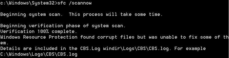

The first time I ran sfc /scannow using CMD, the scan result told me to reboot my PC. I noticed the Windows screen saying "Configuring Windows Update" after reboot. After that, I ran sfc /scannow the second and third time using CMD, the scan result didn't tell me to reboot my PC. There was no Windows screen saying "Configuring Windows Update"after reboots. In the end, the problem still exists. Does the problem solved after I install KB5028224 as you mentioned?
I'm also using the same version of Avast Free Antivirus. Is it the problem?
I found out after I copy and paste files to my external hard drive's Windows Explorer and I close it, my PC pop out Windows Explorer error message every day. I also found out after I downloaded file and open my PC's Windows Explorer to check it and close it, my PC pop out Windows Explorer error message.
The described behavior of sfc /scannow is normal. However, it can only fix errors that are due to missing system files.

I've been using Windows 7 for years on my PC and I haven't switch to Windows 10 or 11 until today. So, what you mean is Windows 10 or 11 doesn't have much freedom and control than Windows 7? You used Windows 10 or 11 before and you don't like it?
My problem is that I can't specifically trigger the crashes: Sometimes after I copy files to a folder and close it, Explorer crashes. Most of the time, however, nothing unusual happens. I have not yet been able to figure out what exactly I must do to cause the crash.
So I can't say for sure if the problem still exists or not.
I found out after I open the folder to check the new downloaded file (I notice there is a green progress bar running at the folder address for a while) and then I close the folder, the explorer problem happens.
In the meantime, several other affected persons should have reported in the Avast forum as well, saying "Me too". – However, this does not happen.

It isn't the particular folder problem. After I download, copy and paste any file to any folder and then i close it, the explorer problem happens.
Or there are difficulties to read the data. Try to scan the drive for errors. There may also be a hardware defect.
The problem isn't just happen to my external drive and also my local drive.
