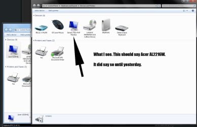

here you go.

So, your monitor was recognized as acerAL2216 till yesterday...
When you uninstalled your monitor in device manager and reboot nothing happened...

Yes it was. Like I said in first post Yesterday morning everything was working fine, but not later that same day and that's when I came and asked help here. When I uninstalled the drivers in Device manager and rebooted, yes, nothing happened.
What makes this problem very odd is that i've been using windows 7 since the RC version was published and I haven't had any problems until now.
