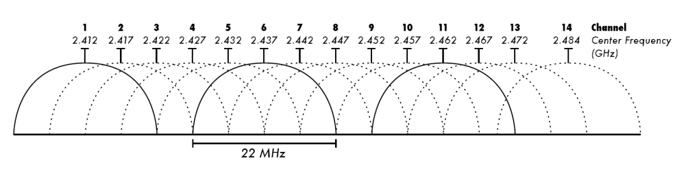

Hi Kyrios, Please check if the router firmware is up to date. Please update the same. Try to connect your laptop directly with the router and check if the connection is intermittent. Mobiles and routers mostly use the same frequencies. So, the connection between them can be flawless.
Many wireless items have a pre-established default channel of six. If you notice a lot of interference with your Wi-Fi connection, changing the channel away from six may solve the problem. However, make sure that all of the wireless devices that are on that same network are also using the same channel. Another thing to keep in mind is that some Wi-Fi channels can overlap with one another. If you keep your channels as far apart as possible, there will be much less of a chance of overlap and interference.

The above post should help however if you have multiple wireless access devices (Routers, access points) in your house and wish to join them then make sure the SSID is the same but you must make sure that the wireless channels are different on each router/access point as this can 'cancel' out the other channels. Channel 1,6 and 11 are the best since neither channels overlap each other. A diagram below should help show how some channels can 'bleed' into others:
   Note
Depending on the type of wireless protocol your wireless router/access points support you may find that it does not support any channels higher than 11.
Also please be aware that these channels can overlap with your neighbors wi-fi therefore some experimentation to be able to pick the best channel may be needed
