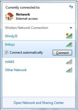

Hi frbas, i assume you already ticked this option like so:

And about the ticking of the reconnect box?:p

I went to changed the power management and deleted the network from the remembered list and that fixed the issue.
