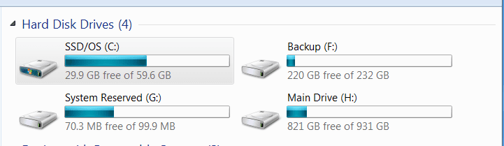

okay, here s a snip of my drives, F, is the one that won't Format, g and h are the same, but also where original OS is. I need to reformat f, copy important files from h, reformat g+h to just G, move files back to G and use F as Backup. I also need to figure out how to restore my profiles for certain programs like Teamspeak3 and Firefox. I am a Moderator and Senior Administrator in my clan and it will take me a week to get all of my permissions set back up correctly otherwise. So, I am hesitant to do anything else until I get the reformatting and moving around done so I don't have to do it all over again.
Thanks All
Thanks All

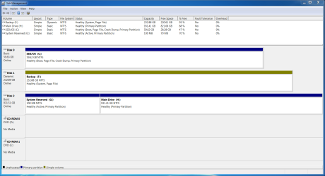

Hmm, I see no dynamic partitions - One could only see it in Disk Management. If Disk Management will not format your F partition, try the bootable CD of Partition Wizard. But I would first try to find out why Windows does not want to format it. There must be a reason.
A full picture of Disk Management would help us to assist you.

@WHS Snip attached

Indeed, there is a lone dynamic partition. How did you manage that.
The only way I know how to fix that is with Partition Wizard 4.2. (an old version). You can download the .iso from Gregs skydrive ( pw422 ). Burn that to disc and go from there.
