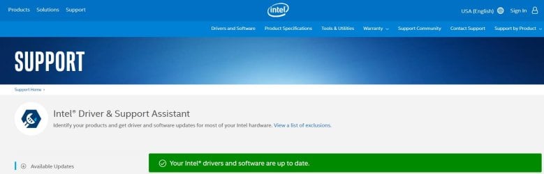

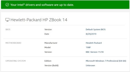

2) I went to Intel website linked by page you recommended. From there I ran the Intel® Driver & Support Assistant, which did a 10 minute scan of my machine. It gave a thorough listing and reported all drivers up to date. See below/attached
