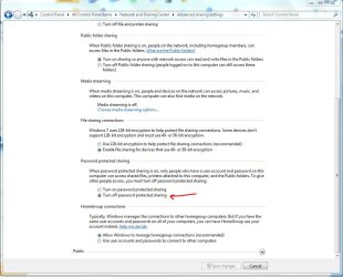

In advanced Network & sharing options is sharing checked as turned off ?
Also does each computer have a different unique name ?

Yes sharing is turned ON and each computer has a unique name. Furthermore I have verified that the Advanced Settings are the same for all 3 computers.

Have you turned OFF Password Protected sharing on all PC's? If not, change it and reboot all.

Yes, Password Protected Sharing is turned off, on all 3 computers.
