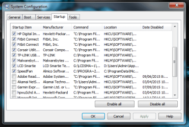

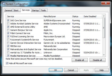

Here ya go, Jack. I included the Services tab, too:
I've scanned again tonight and nothing has been found by all three scanners.

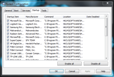

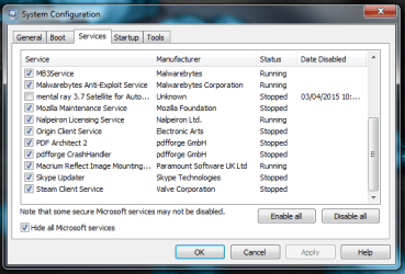

Example from my computer.
