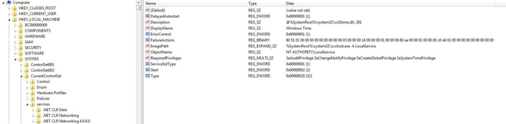

My registry entry here looks radically different: (See attached screenshot.)

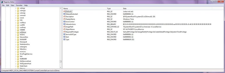

And I am in the area you gave me:
HKEY_LOCAL_MACHINE\SYSTEM\CurrentControlSet\Services\W32Time\Parameters
I did look at your image.

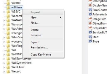

In the 1st image you posted in post #9 you have the "win32time" highlighted.
In my image I have the "win32time" expanded and I have highlighted "parameters"
I am one step ahead of you. Do you have the ability to expand "win32time" ?
That is why I asked what version you are running which is the same as mine.
I can not see in your second image what is highlighted as your image does not show low enough.
I would guess and suggest it is still highlighted "win32time".

The second image I shared is the same as the first just with the tree view on the left scrolled up to show that I have the right area. I can see why you'd think I'm in the wrong one given how radically different my entry is.
Mine lacks sub-folders entirely and the root entries are different.
If you click the picture I originally gave, the full sized image, and you'll see there is no little arrow on the left.
Clearly this is the root of my problem heh. I'm curious how this happened but more interested in fixing it. It's almost like they changed the entire approach to the entry during an update or something at some point and I didn't get it or it didn't apply fully.
Edit: As you can see, expand is greyed out.

Yes I see we are both on the same page now.
I can only now suggest to keep looking for your answer or perform a windows repair.

Hmm. Thank for helping me narrow down the issue. I almost want to make a new thread because this is just weird.
I've got a restore point made, what would happen if you exported your w32time entry and I deleted mine and imported yours?
If we have the same version and yours works it seems like that should solve my problem.
And yeah I've got the disc around somewhere, but it would require a lengthy search I bet finding it XD

Ok, I am now on a new page.
I think that the reason you do not have the expansion on win32time is because it has been unregistered.
If it is registered the required configuration is loaded.
