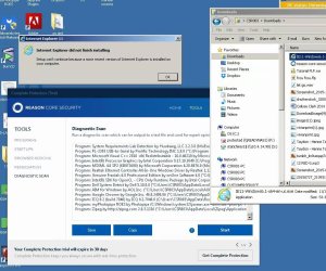

I noticed in the diagnostics it stated IE 9 is installed yet if I attempt to install IE 11 I get the attached screen shot error where it states a newer version is installed.
The main issue is IE 11 no longer running breaking Skype and all IE related apps.
