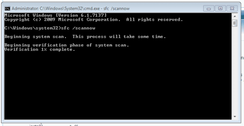

Hi mgebhart, welcome to the forums.
Have you tried booting in safe mode? If you can get in on safe mode then you might want to try the following.
In the start menu search bar type CMD, right-click CMD when it appears & select 'Run as administrator'. Once open, type sfc /scannow which will scan your system file integrity & should restore any corrupt files.
Hope this helps :)

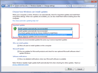

You're welcome Mark,
You can just disable automatic updates after you install, then change the settings to the ones below.
This will notify you of updates and you can choose whether or not to install them. Also, when you have the list of available updates on screen you can right-click each 1 and Hide them so they don't show up again.
Hope this help :)
