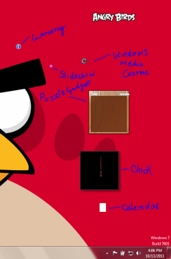

I had installed Kaspersky Internet Security 2012 in my pc. After installation a Kaspersky gadget appeared on my desktop. But when I uninstalled Kaspersky Internet Security 2012, its gadget still remained on my desktop. So I closed it down and uninstalled the gadget. But when I opened the clock, and other default gadgets, they were looking quite funny. As shown in the screenshot
I reinstalled the Windows gadget platform, tried Enable registry.reg, but nothing worked can anyone help me?:(

Looks like Kapersky gadget uninstall may have taken or damaged some Systems files. Try running SFC -SCANNOW Command
Next try System Restore to before you did these things, or even better before you installed or uninstalled KIS. Then try closing the gadget with it's X, or search gadgets to see List of Installed Gadgets and uninstall it that way.
The SFC-SCANNOW command did'nt work, and I have not created any system restore points yet, so is there any other way to fix this problem?:confused:

For those of you who these solutions did not work for here is what finally worked for me! I found that if I created a new user account the gadgets worked fine so I knew it was an issue with the account settings. I found the folder where Windows stores the individual sidebar settings and discovered a settings.ini file in \app data\local\microsoft\windows sidebar for the user account. This controls the startup of the sidebar for the user. I terminated sidebar.exe using task manager, moved the file to the desktop (just in case it was needed) and then restarted sidebar (right click desktop and choose gadgets). I had no initial gadgets but when I added gadgets now they worked just fine. I then deleted the settings.ini from my desktop.
