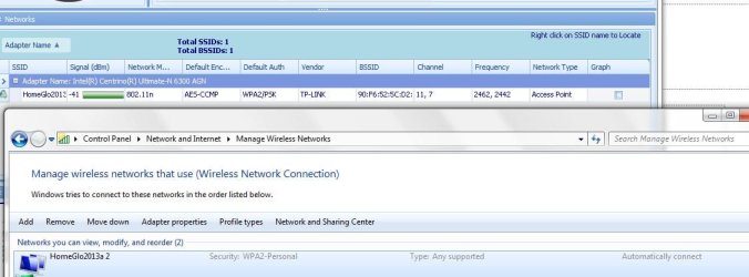

A screen shot of the Xirrus read out would also be helpful. :)

Screenshots attached. I believe the router in question is not the problem because it worked fine for several weeks before the connection issue appeared. Now, when I try the old router that connected happily for over a year I see the same issues. Different brands, same WPA2 seen as WEP problem.
I've stuck the screenshots in a docx file with some small explanation and the text contents of one of the trace files that seemed particularly informative.

More info but still no solution: The nonbroadcasting network that appears in the Xirrus screenshots appears to be our wii u. The bssid shown in the Xirrus screenshot for the non-broadcasting network share the first 5 characters of the mac id of the wii u. The location as shown in the radar map corresponds roughly to the location in the house of the wii u. When I turn off the wii u, the non-broadcasting network goes away.

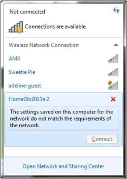

With the wii u off I unplugged the router, waited, deleted the wireless network from Manage Wireless Networks, then rebooted the router and was able to connect with ease. For all of 5 minutes. While composing this reply the connection went away and any attempt to reconnect claims that the security settings do not match. Since the security settings didn't change, something is not being interpreted correctly and I can't even blame the wii u this time around.

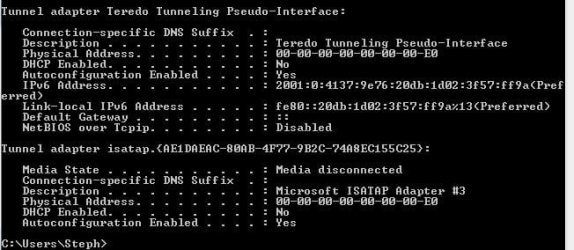

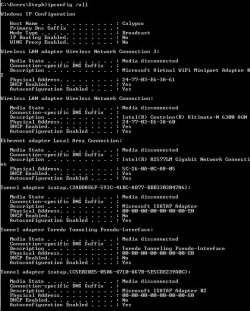

OK, did a hard reset of the router using the 30-30-30 directions and re-input all the security settings. I am currently connected wirelessly, though this is not an indicator of success because I have reconnected previously only to suddenly lose both connection and ability to reconnect until I reboot the router and delete the network from my computer.
Attached are two screenshots of ipconfig /all right now in the working and connected state.

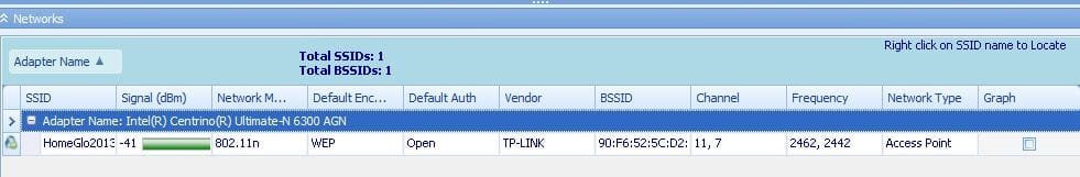

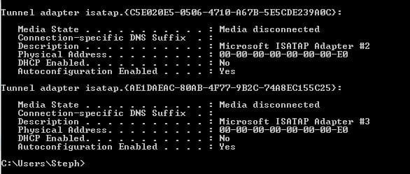

While I was eating lunch the connection got lost again and could not be re-established. So this is before the new motherboard coming this afternoon. I've taken shots of ipconfig below, along with the error that shows if I persist in trying to connect. I've also attached screenshots of Xirrus showing first the network displaying as WPA2. The moment I enter a password in the connection process, however, Xirrus shows the network as WEP (second xirrus image) and I get the security settings error. No changes to the network were made between the screenshots in my last post and the screenshots in this post. No changes to my computer were made either. I looked away and had lost connection.
