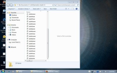

Hi again Ken -
I'm trying to use the Snipping Tool to show you the page I got after unzipping the downloaded files - hope it works
windows 7
To install a driver OR program in compatibility mode - right click the setup.exe file - click properties - click compatibility - check run in compatibility with vista/xp etc - check run as administrator - leave the rest blank. Start setup.exe and install.

unable to continue
Hi Whest -
Thx for yr help.
I'm sorry I'm so ignorant, but I don't how to find the setup.exe from the files I've extracted. The unzipping seems not to have opened them.
chet
windows 7
Before I start it says on the HP SITE your printer isnt supported by W7 -click on your printer listed and it direct you to where it says this on this page :
HP Color LaserJet CP6015 Printer series- HP LaserJet, Color LaserJet and LaserJet MFP Products - Product Support for Microsoft Windows 7 - c01856597 - HP Business Support Center
Sorry had to go for walk - what you will have to do if there is no setup.exe is to go into device manager (right click computer - select properties - select device manager) find the printer - right click on it - click update driver - browse computer for driver - click browse - locate the folder you unzipped them to (put it on the desktop) then the desktop is the top folder in browse - locate the setup information file and select.
I dowloaded the driver and checked it has a set information file (the one with the cog)- ok I m not sure how this will go but as your printer isnt supported this is probably you last shot - good luck! post back
If you cant locate the printer in device manager it will be an unknown device with a yellow asterisk next to it.
*Damn you have downloaded the 64bit driver version I saw that in one of the posts, and then I was reading thru all the posts and you have a 32bit OS of W7 is that correct? Well you will have to download the 32 bit version of the vista driver FOR W7 32bit and do the same as outlined above.

Using compatibility mode just fixes the issue the installer has with the different OS - when there is no setup.exe you can install the driver in device manager which bypasses the installer, and goes directly to the setup info file.
