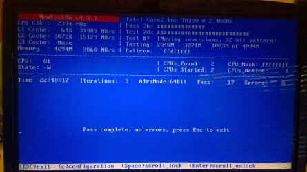

Thnak you AddRAM.
Her is the Memory test screenshot, so I think I can say the RAM is ok: attachment
Is it possible that the GPU does the problem? Is there a software like Memtest for graphic card?
When does actually graphic card com in play in windows 7 boot?
Best Regrds.
